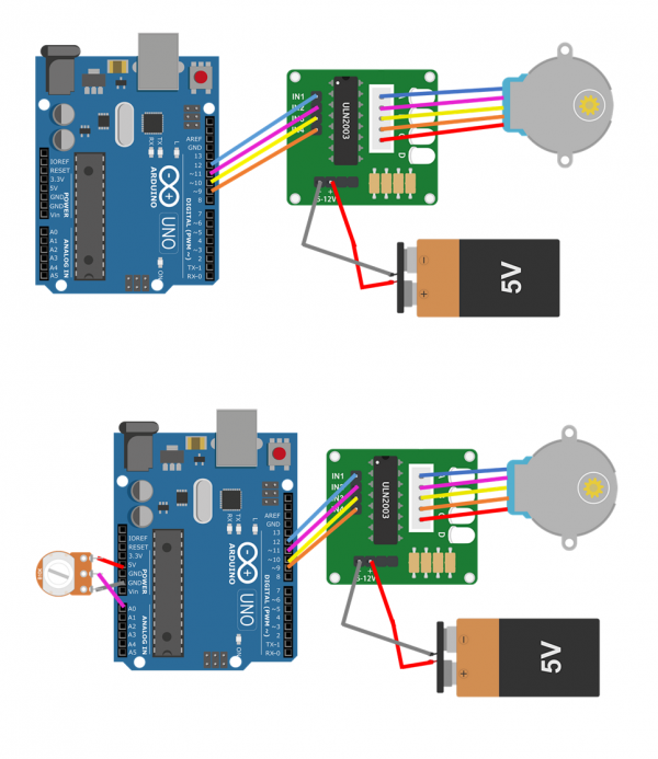

기본 동작 동영상 : https://youtu.be/GJ7Dmjefbak
가변저항 동영상 :  https://youtu.be/qvHy1plHItg

------ < 28byj-48 스텝모터 동작 소스코드 > ---------------------------------------------------
▶ 1024는 180º 이다.
#include <Stepper.h>
#define IN1  12 // IN1
#define IN2  11 // IN2
#define IN3  10 // IN3
#define IN4    9 // IN4
int RPM = 10;
int stepsPerRevolution=2048;
Stepper my28BJY48(stepsPerRevolution, IN4, IN2, IN3, IN1);
  pinMode(IN1, OUTPUT);
  pinMode(IN2, OUTPUT);
  pinMode(IN3, OUTPUT);
  pinMode(IN4, OUTPUT);
  my28BJY48.setSpeed(RPM);
  my28BJY48.step(stepsPerRevolution);
  delay(2000);
  my28BJY48.step(-stepsPerRevolution);
  delay(2000);
------ < 가변저항을 이용해 스텝모터의 회전 각도 제어 소스 코드 > ---------------------------------------------------
#define Potentiometer  A0
int stepsPerRevolution = 1024;
int sensorReading;
int motorSpeed=10;
int PotentiometerValue;
Stepper myStepper(stepsPerRevolution, IN4, IN2, IN3, IN1);
 pinMode(Potentiometer, INPUT);
 myStepper.setSpeed(motorSpeed);
  sensorReading = analogRead(Potentiometer);
  stepsPerRevolution = map(sensorReading, 0, 1023, 0, 2048);
  if (motorSpeed > 0) {
    myStepper.step(stepsPerRevolution);
  delay(2000);
